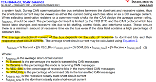

As per datasheet of TCAN1044-Q1,
to solve equation 2 for IOS(AVG), how to get values for %Transmit, %Receive, %REC_Bits, %DOM_Bits?

Hi Abhishek,
%Transmit as an example will be 0.1 if you have 10 nodes with a single node transmitting (1/10).
%Receive in this example will be 0.9 as only the single node is transmitting and 9 receiving (9/10).
%REC_Bits and %DOM_Bits will be 0.5 as most nodes in a CAN network are in recessive state almost all the time (i.e. just receiving). About 50 % of the time one node is driving the bus, likely with about 50 % dominant bits and 50 % recessive bits, thanks.
