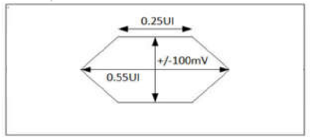

I am facing the similar situation and I am wondering there this SGMII mask is define. I did not found any definition like that. Can you help ma and name the standard / specification. thank you

Thank you for replay. Where this mask come from, where this mask is define, what standard?
Hi Viktor,
This mask is derived from SGMII spec:
https://ia803002.us.archive.org/25/items/sgmii/SGMII.pdf
Thank you,
Evan

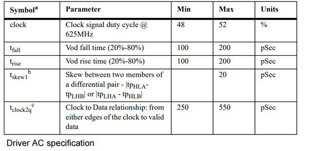

Thank you Evan, this help me a loot. I am just do not understand where the 180ps and the 0.55UI / 0.25UI definition come form. I do not see it in specification.
Hi Viktor,
The 180ps is arbitrary margin, please only consider the spec defined within the eye for reference:
Regarding 0.55UI / 0.25UI, this is from Driver AC specification:
The diagram assumes rise/fall time of ~144ps.
0.55UI - 0.25UI = 240ps (full signal rise/fall)
(20%-80%) x 240ps = 144ps
