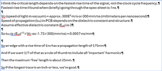

  • Hi David,
    Thanks. Just to be clear, these termination resistors are always in place and are not able to be disabled. Is this correct?
    There is a "part B" to this question concerning the need to rout the signals with 50 Ohm traces. Am I correct in saying that if the trace is very short (around an inch or so) we don't need to worry about that because it is shorter than the 1/4 wavelength of any harmonic we care about. Does this sound right to you? This implementation is in a very small PCB so everything is very tight. Below is the engineers (conservative, IMO) analysis.
    Mark
  • Hi Mark,
    These termination resistors are always in place and are not able to be disabled. Is this correct?
    Correct.
    I think it is best not to calculate/estimate the performance effect on paper. We should recommend to route the MAC interface traces as 50ohm, no matter the length, as recommended in the datasheet. We have IBIS models available if detailed analysis is absolutely required, but 50ohm guidance should be followed regardless.
    David
