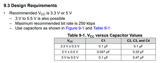

I reviewed the charge pump functionality in the application note, How the RS-232 transceiver’s regulated charge-pump circuitry works, and based on Equation 2 from the document, I attempted to reduce the ripple by adjusting the capacitor values. I changed the capacitor values C1 = 0.1µF and C2, C3, C4 = 0.4µF, which reduced the ripple to approximately 500mV. I also tried increasing the values to C1 = 0.1µF and C2, C3, C4 = 1µF, as suggested by the waveforms in the document, but the ripple voltage increased to approximately 650mV.

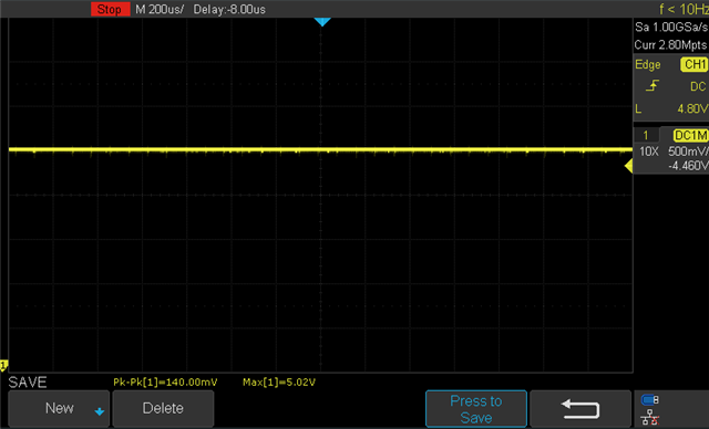

  • Hi Clemens and Ethan,
    There no short on the 5V rail. Below is a screenshot showing the 5V rail across the bypass capacitor.

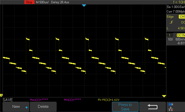

    Additionally, here is a screenshot of the ripple observed on the pin V+. In this measurement, C1,C2,C3, and C4 are all 0.1uF, and the ripple is approximately 1.5V.
    To reduce the ripple, I adjusted the capacitor values:  C1 remains at 0.1uF, while C2,C3, and C4 were increased to 0.4uF. With this adjustment, the ripple decreased to approximately 500mV.

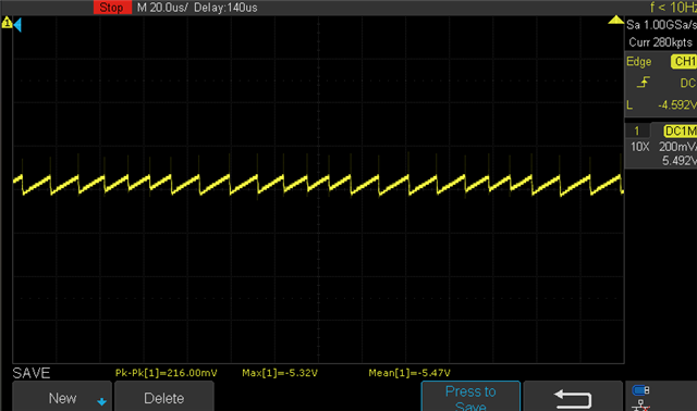

    Below is a screen capture showing the V− rail, measured across capacitor C4, which is located directly beneath the V− pin of the transceiver.
    The average voltage of the V+ rail is 6.35V, and the average voltage of the V− rail is 5.47V.

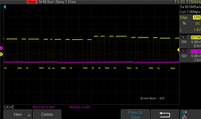

  • I realized I forgot to attach the screenshot of the data at the DOUT pin in my earlier post.
    Here is the screenshot showing the data transmitted through the transceiver, measured at the DOUT pin.

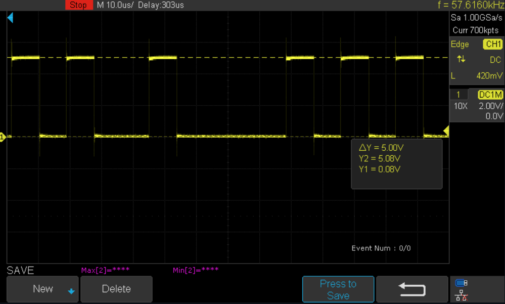

    Here is the data at the DIN pin of the transceiver.

    We only guarantee that the device will be fully functional with the capacitance values listed in the datasheet. However, you can attempt custom capacitor values at your own risk. The critical piece here is the ratio between C1 and C2,C3, C4. Rule of thumb is that there should be between a 10:1 to 5:1 ratio with the C1 being the smaller value, and no capacitors should be larger than 1uF.
    For the DOUT image you recently posted, what capacitor values were used? If 0.1uF were used for C1-C4 with VCC at 5V, then it makes sense why the peak is higher using the formula in that charge pump article.

  • An RS-232 receiver has an impedance of about 5 kΩ.
    In the waveforms shown, the bus output is negative, so both V+ and V− are loaded. (V− is generated from V+.) The high-frequency ripple is the V− charge pump. The lower-frequency ripple is the V+ charge pump, and I do not know why it does not switch with a higher frequency.

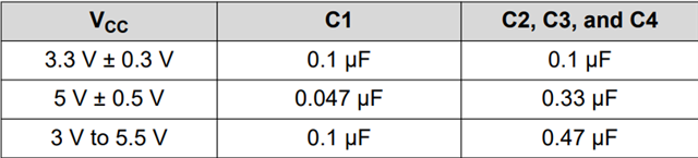

    As far as I can see, you are not using the capacitor values recommended for a 5 V supply. Please check how the ripple looks with the correct values.
    The capacitor(s) at the VCC pin can be increased if you want to reduce the ripple on your 5 V supply.
    The capacitors at the V+ and V− pins can be increased to reduce the ripple on the output supplies, but then they will take longer to power up.
    You should not change the flying capacitors (C39, C43) from their recommended values/ratios. Increasing them will increase the ripple and lower the ripple frequency.
