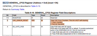

Hi expert,
The CRC_ERROR_RESET register with the value 0x04 is used to clear the LINK_LOST status for both ports or should it be used to select and clear the LINK_LOST status for the corresponding port only?

Hi Xiaoxiang,
This bit is port specific. You would need to set the port you are reading/writing to using Register 0x1E - TX_PORT_SEL (mentioned in the datasheet).
