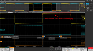

When I test the Transmitter Output Droop of PMA, I find that the waveform has 67MHz-68MHz ringing.
Is it normal?

Hi Wang,
The ringing you have pointed out is expected. This does not effect the result of transmitter output droop test. Are you seeing a passing result?

Hi David,
The test result is pass.
Why does it have the ringing?

Hi Wang,
This is due to internal filters used to generate the test pattern and is expected. As you have stated the result is passing, there is no issue.
