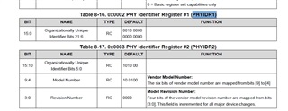

  • Hi Alvaro,
    We have connected STM32H7 RMII Lines to DP83822, we have tried the below,
    We read the PHYIDR 1 and PHYIDR2 Registers, and we verified with Datasheet Values 0x2000 and 0xA240.
    I need help in confirming this, whether PHY is detected correctly or Not? also PHYIDR1 & PHYIDR2 is the exact register we need to check
    Rajesh
  • Hi Rajesh,
    Are you saying that you were able to successfully read registers 0x2 & 0x3? If so then yes, the PHY is detected! Register access is a good indication if the PHY is alive and if the correct PHY Address is configured.
    Alvaro

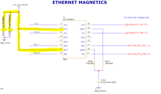

  • Hi Rajesh,
    This is strange, the PHY should have been able to link up when the ethernet cable is connected. Looking at the MDI portion of your schematic, the only thing I can see that might be off is described in the table below. When the Ethernet cable was connected, what was the Link Partner? Can we confirm if the Link Partner is able to link up with other ethernet devices?
    Customer Schematic Datasheet Recommendation Remark
    Center taps should both have their own 0.1 & 1 uF caps. Customer's schematic shows both center taps connected to the same caps.
    I doubt this is the cause for the current issue, but is worth pointing out.

  • Hello Alvaro,
    Thank you very much for your detailed review and support.
    I’m pleased to inform you that we have successfully established the connection with the PC.
    When our board is connected to the Windows PC, it detects the Ethernet connection, and the speed tab correctly identifies 100 Mbps (even without internet access).
    The issue was traced back to the baseboard connection, as we are using a stacked board design.
    Our software team is now working further on this.
