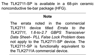

I want to make Test Rig for testing of TLK2711-SP interface. I have got a component TLK2711AJRGQE. where it says both of them are functionally same. Please confirm whether both parts are same except their grade / packaging or their any functional changes between both the parts.

    That's correct, TLK2711A and TLK2711-SP are functionally equivalent. The key difference is that TLK2711-SP is space grade and TLK2711A is not. However TLK2711A is obsolete, so we cannot offer detailed support for this device and recommend using TLK2711-SP instead.
