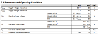

My client has some questions about how the datasheet specifications should be viewed.
1. The customer said that VIL VIH VOL VOH these parameters have a maximum value and a minimum value or an intermediate value. Which one should be compared to be correct, or should it be within this range? In addition, why do some have only maximum values ​​and no minimum values?
2. Can you also help explain what VLC is?
3. And why does VLC have 0.45 and 0.4, which value should customers look at?
Boyan
  • Hi Boyan,
    When designing in this device, I recommend design for max / min conditions.
    Some only have maximum values according to the I2C standard. For example VIL only has maximum because you must be at or below 30% of VCCA in order to be considered a LOW by the device. The minimum spec is technically GND, as it is assumed that voltage will not go past ground. Abs. max has the negative voltage spike on the input to be -0.5V which any further could cause potential damage to the device due to violating abs. max spec.
    VILC is the minimum voltage that is required to pass a LOW from B-side to A-side.
    VILB = VILC. The target on B-side must be able to pull the bus low to a VOL < VILC = 0.45V.
    This is a datasheet error. I submitted a ticket for the revision.

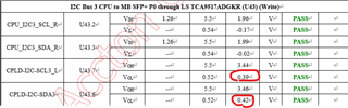

  • HI Tyler
    here is Tommy from ACCTON
    I have some question for the TCA9517A spec
    in the befoe we use the spec like picture below
    TCA9517A
    input VIL Aside
    input VIH Aside
    <0.3VCCA
    >0.7VCCA
    <5.5V
    TCA9517A
    ouput VOL Bside
    >0.45V
    <0.6V
    TCA9517A
    input VIL Bside
    input VIH Bside
    <0.45V
    <5.5V
    >0.7VDDB
    TCA9517A
    output VOL Aside
    <0.2V
    that inculding the VILC
    If there has any wrong, pleasw tell me
    Tommy

  • Hi Jack
    I have some question for tca9517A
    ouput VOL Bside
    >0.45V
    <0.6V
    In our measurement it only0.39V and 0.42V
    it's that currect?
    Tommy
  • How exactly did you test this? The TCA9517A itself will output more than 0.45 on the A side, but other devices can pull the lines lower.
  • Hi Tommy,
    VOLB is >0.45V and <0.6V across voltage and temperature.
    Same question as Clemens here... how was this measured? This seems incorrect.
    Tyler
  • we use the 1.8V(PULL UP 1K ohm) and shifting to 3.3V(PULL UP 1K ohm)
    in the sumulation, it can meet the spec on VOLB
    but in the measurement result is lower than 0.45V
    That is werid. here is the measurement picture
    we probe it on IC.
    Tommy
  • What voltages are applied to the signal lines? If there is I²C communication going on, then all devices are pulling the lines low at some time, and you will see lower voltages.
  • We use th 1.8V  to signal lines and want ro change to 3.3V
    so u mean in the difference situation
    the measurement will lower than 045V
    But in simulation we doesn;t see this issue
    Tommy
  • Hello
    The team is currently on Thanksgiving holidays. Pls expect response delay till Dec-2nd. Thank you for your patience.
    BR
    -Yuan
  • Hi Tommy,
    The datasheet specifies that when driving a LOW from A-side to B-side, VOLB is at least 0.45V up to a max of 0.6V output voltage when IOL is between 100 uA and 6 mA of loading (this loading changes depending on the equivalent pull-up resistance on B-side).
    What Clemens is talking about is the scenario that some peripheral I2C device on the B-side is driving the bus LOW. The output low voltage on B-side could be lower than 0.45V depending on what device is driving the LOW.
    If you are certain that communication is occurring from the buffer by driving a LOW on A-side first, then B-side drives LOW, then this is the buffer driving the LOW in which the voltage should be between 0.45V and 0.6V as long as the IOL, ambient temperature, and VCCB voltage is respected according to the datasheet test specs.
    Do you have scope captures of the measured voltage? Would there be any error in the measurement on the scope? Are the scope probes calibrated?
    Has this been repeated across multiple TCA9517A's?
    Tyler
