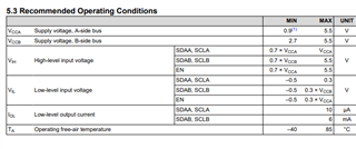

My client has some questions about how the datasheet specifications should be viewed.
1. The customer said that VIL VIH VOL VOH these parameters have a maximum value and a minimum value or an intermediate value. Which one should be compared to be correct, or should it be within this range? In addition, why do some have only maximum values ​​and no minimum values?
2.Can you also help explain what VLC is?
for example: the TCA9509 shows the VILC is MIN: 0.11V TYP:0.15V,
That means the waveform will <0.15 >0.11, or I misunderstanding.
    The VIL/VIH are based off the I2C standard.
    The VOL is based off of the buffers ability to drive a low output signal.
    The VOH is "driven" by the pull-up resistor on the I2C bus.
    I explained this in the TCA9517A thread, it is essentially the same as in that device except for the direction
    VILC is the minimum voltage needed to pass a LOW from  A-side to B-side. It is recommended to ensure that all devices on the A-side of the TCA9509 are able to drive below a VILC(min). This means <0.11V for the respective voltage range.

  • HI Tyler
    here is Tommy from ACCTON
    I have some question for the TCA9509 spec
    in the befoe we use the spec like picture below
    TCA9517A
    input VIL Aside
    input VIH Aside
    >-0.5
    <0.15V
    >0.7VCCA
    <1.8V
    TCA9517A
    ouput VOL Bside
    <0.2V
    TCA9517A
    input VOL Aside
    <0.3V
    TCA9517A
    output VIL Aside
    output VIH Aside
    >-0.5V
    <0.3VCCB
    >0.7VCCB
    <5.5V
    that inculding the VILC
    If there has any wrong, pleasw tell me
    Tommy
  • Hi Tommy,
    The numbers look correct, but I am assuming the parameters were mislabeled, please see updated table below:
    TCA9509
    input VIL Aside
    input VIH Aside
    >-0.5
    <0.15V
    >0.7VCCA
    <1.8V
    TCA9509
    ouput VOL Bside
    <0.2V
    TCA9509
    input VOL Aside
    <0.3V
    TCA9509
    output VIL Bside
    output VIH Bside
    >-0.5V
    <0.3VCCB
    >0.7VCCB
    <5.5V
