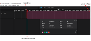

Hello Fadi
for the OEN activation letency of 6 ns is understood
Now the point is the for "reset by programming Register 0x01[0] for digital blocks" how additional delay will be consumed by this operation to have LVDS output operational again ?

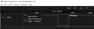

Hey Nabil,
Depending on your I2C speed, display delay, video source delay, etc.
928 Lock will toggle within ~620 us when a digital reset is issued.
Display video will come back up within ~2 seconds total time on a typical bench setup with 927-928 using 927 internal patgen and a PC monitor.
