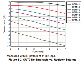

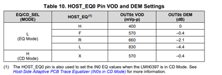

2. The IBIS-AMI model includes a model-specific parameter called VOD0.
Is this parameter the same as the one described in the LMH0397 Programming Guide under section "3.14.1 OUT0 VOD Settings"?
3. The documentation mentions that "Overriding Host_EQ0 pin setting enables register control of the output VOD settings." Is it possible to achieve the same VOD0 settings using the pin configuration alone, without modifying the register settings?
My intention is to avoid basing our product design specifications on the parameter settings of the IBIS-AMI model.
If enabling the pin and configuring it through circuit design is sufficient, we prefer not to alter the register contents unnecessarily.
