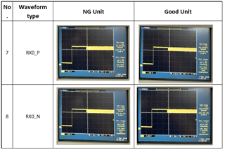

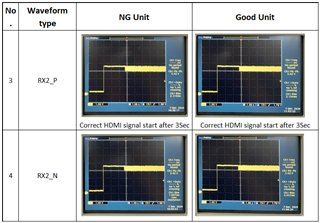

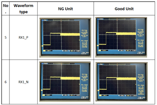

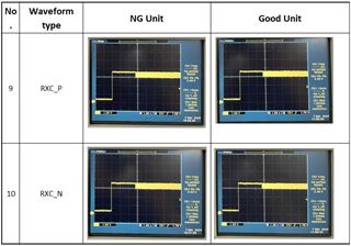

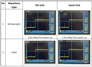

TFP401A: Garbage Display or Distorted Image appeared during Boot up (2-3secs)
Part Number: TFP401A
Other Parts Discussed in Thread: TFP401
We are using TFP401APZP to our display a-SI TFT 800(RGB)x600, everything is fine except for Garbage Display or Distorted Image appeared during Boot up (2-3secs) only, Rejection rate is around 20% to 30% we do parts swapping of good and NG units (Swap ABA)- and the result followed IC refer to the video and related report.
QCR24-10-009 TFP401APZP.PDF
