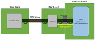

The customer would like to use SN65DP141 like below concept.
As you can see below, 100 ohm impedance between Base board and DP141 board but 85ohm impedance between DP141 and display panel.
The datasheet of SN65DP141 mentioned, the diff. pairs impedance is 100ohm.
Is there any side effect with different input/output impedance ? please let me know your opinion.
