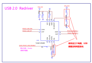

At present, a new Pogo interface keyboard for USB2.0 high-speed USB interface is developed. Due to the long USB line of the keyboard, the USB Redriver TUSB212RWBR IC is added. At present, the test eye diagram shows that the configuration resistor of this IC corresponding to DC_BOOST and AC_Boost is adjusted. It doesn't work. It doesn't look like the IC is working. The specific schematic diagram is as follows:
