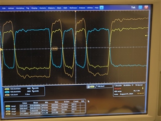

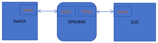

 (1)   I use dp83869 as a RGMII to SGMII Bridge to connect SOC and switch.

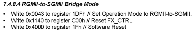

 (2)   I configured the following registers to make dp83869 work in bridge mode:
(3) After the configuration,  when I power on the system,  I found the switch SGMII and DP83869 SGMII can not link up each other.
Can you help to analyze the reason?
Thanks.

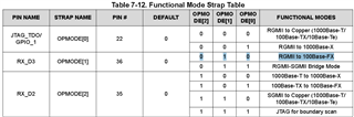

    In addition, I found BMCR reg 0x00 power up default value is 0x2100, not as datasheet specified value 0x 1140.
                                   BMSR reg 0x01 power up default value is 0x6149, not as datasheet specified value 0x 7949.
    Our bit12 of reg 0x00 is zero by power-up default, why?

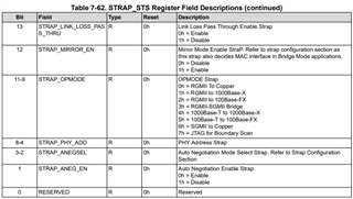

  • And the register reg0x6e read out value is 0x0454

    Taking a look at the bits 11-9 above, it also looks like the auto-negotiation strap is set to disable, which is why bit 12 was 0 for you when you read it in register 0x00
    This is for the MDI line auto-negotiation, which shouldn't matter when being used in bridge modes.
    Can you also confirm that the extended register space access steps were followed while writing these registers to enable bridge mode? If possible, I'd like to read the register 0x1DF to make sure that the value 0x43.
    Can we probe the SGMII signals (SO_P/SO_N & SI_P/SI_N) to make sure they are as expected? It should look similar to the following
    Channel 1: SO_P
    Channel 2: SO_N
    Channel M1: CH1 - CH 2
    Vivaan
    Were you able to gather these waveforms?

        Our hardware only pulled up RX_D3 to high, and leave  RX_D2 and JTAG_TDO/GPIO_1 default low.  Boot-up mode is RGMII to 100Base-FX.
    After boot up, SGMII auto-nego was disabled.  And I tried to enable it, but failed.
    Can you help how to set registers to  make auto-negotiation successful?
  • After boot up, 83869 entered “RGMII to 100Base-FX” mode by strap.
    " reg(0x 0) = 0x2100 " means auto-nego is disabled.
  • I found this from datasheet:
    Our 83869 strp pin is in  “RGMII to 100Base-FX” mode.
    I wonder if we have ways to restart auto-nego when 83869 mode change from  “RGMII to 100Base-FX” mode to "GRMII SGMII bridge" mode by software.
  • Hi Chenglei,
    Thank you for the register dump and all the information
    I think you are confusing the MDI auto-negotiation with the SGMII auto-negotiation. The auto-negotiation referred to in the register 0x00 is the MDI auto-negotiation. Since in Bridge Mode, the MDI side is not used, this setting is not applicable at all. The SGMII auto-negotiation can be checked through register 0x14 bit 7, which according to the register dump you provided, is on.
    Additionally, can you read register 0xC00 after writing the following registers ONLY (to put the PHY into Bridge Mode)?
    I think this would confirm if the PHY is actually switching modes using that command since this register should change to reflect the new mode.
    Channel 1: SO_P
    Channel 2: SO_N
    We can probe these signals from bootup to after writing the register changes to change into bridge mode.
    Vivaan

      But I find another problem.  The SGMII port on our switch can only work as MAC mode, and can not be set to PHY mode.  You know, SGMII communication needs the SGMII two ends be set MAC mode and PHY mode respectively.
       When 83869 in "RGMII-to-SGMII Bridge Mode", could the SGMII of the 83869 be set PHY mode?  Is there any register to set PHY mode?
  • Hi Chenglei,
    Glad to know that the problem was resolved? What seemed to be the problem/fix in this case? It might help solve other peoples issues in the future so I like to keep track of things like this on E2E.
    The PHY acts only as a physical layer for ethernet communication. Because of this, it lacks the functionality of selecting modes. Ethernet switches can be used in multiple different configurations, switch to MAC, switch to PHY, and even switch to switch, which is why a switch needs different modes to differentiate between these use cases.
    Vivaan
