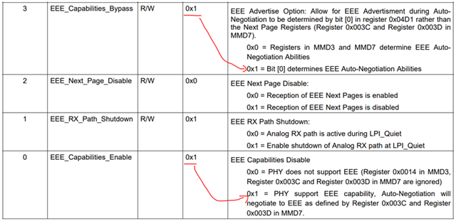

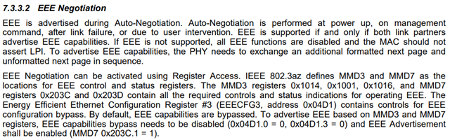

Hi Hayashi-san,
DP83825 still need MAC to perform the support EEE.
Hillman Lin
Hi Lin,
What procedure is needed for MAC? Is there any document to support EEE as a system?
Hayashi
Hi Hideki,
We have detail document talk about EEE for DP83822. It should be similar procedure on DP83825.
