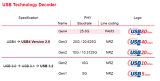

I check the Differential Insertion Loss on the datasheet that is 3dB@ 10GHz.
Does TPD4E02B04 can be used on USB3 gen2 (10Gbps)??
And TI support other ESD DIOD for USB4; 20Gbps, 40Gbps, 80Gbps  or give me any other suggestions??
  • Hi Gordon,
    Yes, TPD4E02B04 can be used on 10Gbps speeds. For estimating this, we use the 3dB mark on the insertion loss then use frequency*2 to get the data rate.
    For higher speeds, we have our lowest capacitance diodes: TPD1E0B04 and TPD1E01B04. TPD1E0B04 is able to support roughly 50-60Gbps. TPD1E01B04 is able to support roughly 40-50Gbps.
    Please let me know if you have any questions.
