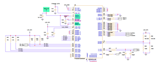

Hi HSSC team,
Looking at the schematic, I noticed that the VBUS of Type-C receptacle is not connected to [U6] TPS65987DDH's VBUS1 or VBUS2, but connected to PP_HV1. Is the connection between VBUS and VBUS_DS reversed on the PD area?
I understand this IC is under PI team but can you check it?
Also, in regards of the EVM manual, there are no instructions.
How is J5 (VBUS, VBUS_DS, and SYS_POWER) supposed to be used with the external barreljack and Type-C source/sink?
