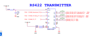

    Following is our schematics. We have interfaced the AM26C31 inputs to an FPGA bank operating at 3.3V. Please let us know if this is ok.
  • The input leakage current of the AM26C31 is at most 1 µA, so the FPGA's actual VOL and VOH values are near 0 V and 3.3 V; the margin us much larger. (For CMOS outputs connected to CMOS inputs, VOL/VOH calculations usually are not necessary.)
    There is no signal from the transmitter to the FPGA; the last two columns are meaningless.
    The 4A input must not be left floating; connect it to VCC or GND.
    Clemens is correct. The A pins of the Am26C31 device are high impedance so the VoH/VoL of the FPGA to the A pins should pull close to Vcc/GND since A pin isn't a strong current source (your VoH and VoLs from the FPGA are likely rated for mAs of current but the A input is probably sub uA which is why they will push closer to GND/Vcc).
    The VoH/VoL specs from AM26LV31 don't mean anything to the FPGA if its interfacing on the a pin.
    Please also note that Clemens comment about not letting 4A float is correct as well. Tie this pin to Vcc or GND with a resistor to prevent shoot through current.
