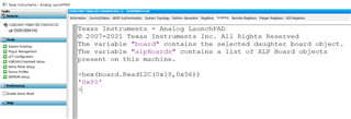

DS90UB941AS-Q1: Unable to open left and right mode (LEFT_SIGHT_3D BIT always reads 0)
Part Number: DS90UB941AS-Q1
Initialize the registers in the following order, and it was found that the values written to the registers related to SIZE (IMG.LINE_SIZE0/CROP) were different from the values read back, making it impossible to open the left and right mode (LEFT_SIGHT3D BIT always reads back as 0).
How to set the left and right modes?

write addr 0x18 reg = 0x32 value = 0000, read back val = 0000
write addr 0x18 reg = 0x33 value = 0x05, read back val = 0000
write addr 0x18 reg = 0x34 value = 0x0c, read back val = 0000
write addr 0x18 reg = 0x56 value = 0x80, read back val = 0000
write addr 0x18 reg = 0x1e value = 0x01, read back val = 0x01
write addr 0x18 reg = 0x04 value = 0x20, read back val = 0x20
write addr 0x18 reg = 0x36 value = 0000, read back val = 0000
write addr 0x18 reg = 0x37 value = 0x80, read back val = 0000
write addr 0x18 reg = 0x38 value = 0xff, read back val = 0000
write addr 0x18 reg = 0x39 value = 0x04, read back val = 0000
write addr 0x18 reg = 0x3a value = 0000, read back val = 0000
write addr 0x18 reg = 0x3b value = 0000, read back val = 0000
write addr 0x18 reg = 0x3c value = 0xff, read back val = 0000
write addr 0x18 reg = 0x3d value = 0x02, read back val = 0000
