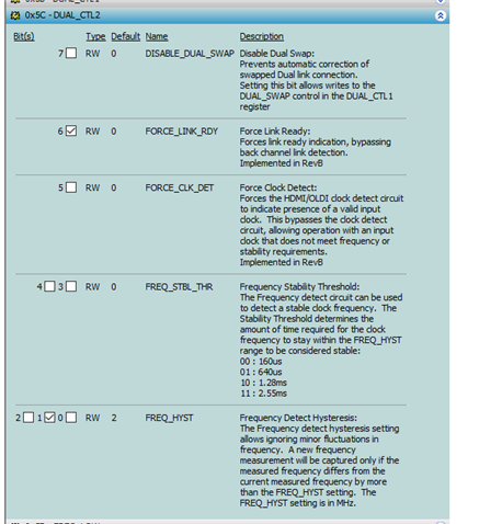

  • Hi Abhishek,
    Thank you for the register info. Is the display module containing the UB948 powered on? The UB949 is not detecting any deserializer the link.
    What are you using as the HDMI source? In register 0x50 (BRIDGE_STS), there is no detection of the RX_5V signal on the HDMI interface.
    Regardless of the deserializer status, you can force the link ready status in the UB949 to allow the HDMI source to send video to the UB949. To force the link ready status, enable bit 6 in register 0x5C (DUAL_CTL2).

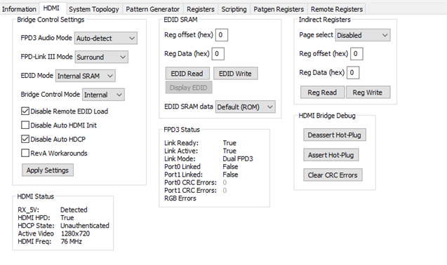

  • Hello Jack,
    Yes, we are using an HDMI source from the laptop, and we have applied the register settings as per your suggestion. For reference, I am attaching the images below.
    Below are complete details of our system
    1. We are using UB949A EVM as serializer & UB948 as deserializer on Display TFT PCB (Resolution: 1920*720)
    2. we are currently testing the video with help of laptop.
    3. Display Deser Address: 0x58 (8bit) / 0x2C(7bit)
    Can you please support in below points
    1. we are able to detect the video source, But we are still unable to detect the deserializer. We have already verified the required power at the deserializer board (UB948).
    2. support to generate the EDID file for 1920*720 (attached the display specification below)
    3. Please check the Register configuration & any Hardware registers need to changed according to the deser side Schematic.
    4. 1920*720 is unusual resolution to create video from laptop, can we use the PATGEN to create the pattern and disconnect the HDMI source?
    Kindly suggest the next appropriate steps for the bring-up process.
