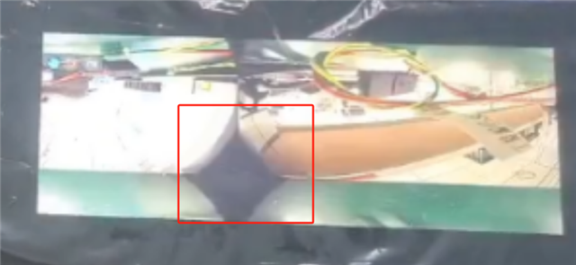

Dears,
   The customer uses DS90UB934 for the Deserializer and DS90UB933 for the camera. In a normal office environment, there may also be abnormal reverse images. As attached, the screen has been segmented. Could you please help me identify where the problem may be? thank you!
  • Hi Jon,
    Thanks for this info. Would you be able to provide background on the below questions?
    1. Could you please provide register dumps for the serializer / deserializer in the abnormal case?
    2. How often does this abnormal behavior appear on the display?
    3. Would you be able to provide a block diagram for the optical path? Are there other devices between the UB934 and display?
    Appreciate the info here.
