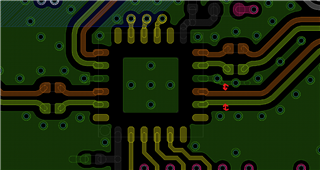

In Section 8.4.1 Layout Guidelines (P.15) of the latest datasheet (rev.E), it is stated at the end:
“Each pair must be separated by at least 5 times the signal trace width.”
Does this refer to separating the TX pair from the RX pair? Or does it also mean that SSTxP and SSTxN within the same pair need to be separated?
Looking at the diagram on page 16, it appears that all four lines (TxN, TxP, RxN, RxP) are separated. I would like to confirm.
