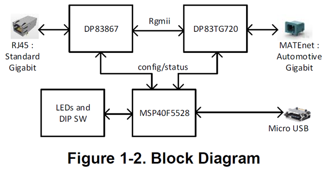

  • We are follow DP83TG720 EVM board design.
    The RJ45 on the left side of the EVM block diagram contains a Transformer inside.
    But because
    1. Insufficient PCB space
    2. Currently, DP83867 and i210-IT are on the same PCBA, without any wires.
    Is it possible to connect DP83867 and I210-IT through AC coupling capacitor without the need for RJ45 internal Transfermer?
    If according to your notification DP83867 does not support AC coupling design,
    So is it possible to connect directly to i210-IT?
    EVM : DP83TG720 block diagram :

  • Currently discussing the MDI interface.
    From I210-IT's MDI interface to DP83867
  • Hi Ben,
    Unfortunately, DP83867 does not support transformless application on MDI interface. Could you use transformer between the two PHY. If you are looking for transformerless application, we highly recommend DP83869.
