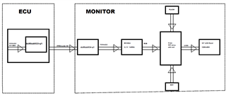

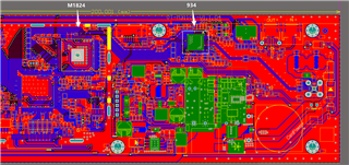

When using DS90UB934-Q1, the frequency is 456.23MHz, which emits a lot of radiation and affects the surrounding circuits. DS90UB934-Q1 outputs DVP to MS1824, PCLK clock is a 76MHz accessory, which happens to be a multiple of 456. Adding magnetic beads to the DVP circuit reduces radiation by more than 20db. Adding shielding covers near the DS90UB934-Q1 and DVP lines reduces radiation by approximately 8db.
The customer has the following questions, please help answer them. Thanks!
1. Is 76 MHz related to the input rate of LVDS video? For example, 1080p corresponds to 76MHz, and 720p corresponds to other frequencies.
2. 456 MHz should be the transmission rate. If it is the data transmission rate, what determines it? How to calculate? Why is it a 6-fold relationship?
3. Can DS90UB934-Q1 set and adjust any registers or modes to reduce radiation output?
4. Is SSCG modulation effective in reducing radiation?
5. Is it a problem caused by circuit design? Do you have any good suggestions? The PCB diagram is shown below.
    Can you please share the schematic and layout files for review? For layout, we would like to see the actual project file as this provides better visibility.
