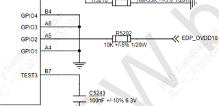

my customer is using SN65DSI86 on Qualcomm SM6225 platform, with zhongshen EDP display. customer found sometimes the display has flicker issue, checked SN65DSI86 and found 0xF6 is 40, which is LOSS_OF_DP_SYNC_LOCK_ERR, could you please help give more info/guidance what would cause this error?
Stone
  • Stone

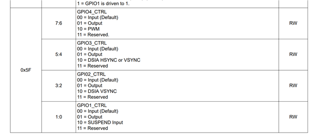

    Sometimes errors flags can be set at power-on or during start of the DSI stream. For this reason, it is recommended to clear flags by writing 0xFF and then reading back status flags. The bits which remain set are the errors which should be focused on.
    Address 0xF6 thru 0xF7 report errors associated with DSI to DP video timing. Typically, errors are set in these registers when video timing programmed into DSI86 doesn’t match timing received on the DSI interface. It is important the DSI86’s video registers located from 0x20 thru 0x3A match video timing used by the DSI source. The DSI86 will derive the DP timings from values programmed into these registers.
    Can they please share their eDP display spec and DSI86 register programming values?
    Please also map HSYNC and VSYNC to the DSI86 GPIO pins using register 0x5F and measuring HSYNC and VSYNC frequency, do they meet the eDP display requirement?

  • hi David :
    DSI86 register programming values  and eDP display spec
        Lontium SN65DSI86 MIPI to EDP driver

    Can you please map HSYNC and VSYNC to the DSI86 GPIO pins using register 0x5F and measuring HSYNC and VSYNC frequency, do they meet the eDP display requirement?
    David
  • Hi David:
      I wrote 0x5F 0x08 at the end of the initialization, is OK? And then we measure the corresponding HSYNC and VSYNC frequency?
    Yes, you can write 0x08 to register 0x5F after initialization, and remove R5202, this will let you measure the VSYNC. But you need to lift GPIO3 pin to measure the HSYNC frequency.
