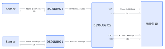

Hello, as shown in the picture, can you use one DS90UB9722 and two DS90UB971 to complete two 4K60 image transmission, thank you!

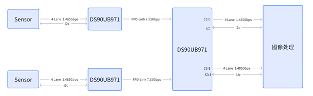

One quick note on the diagram here: the UB971->UB9722. The picture labels the DES as the UB971 in this diagram.
Beyond this quick note, this application will be supported from the devices based on the data shared. The UB971 will support up to 1500Mbps/lane including blanking. The CSI output rate from the UB9722 will be ~1.6Gbps as the CSI transmitter operates at fixed rates.
