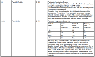

    I took a look at the registers provided as well. I noticed that there were several idle errors, auto-negotiation error interrupt, and polarity change error interrupt.
    Given that in fixed slave mode, there are no communication issues, I believe you are correct, the master/slave resolution seems to be the problem here.
    Since we do not have much information about the STB, and the issue seems to occur 1/200 times that the STB is reset, it looks like we have stumbled upon a marginal case where 1/200 times, the auto-negotiation between the devices fails. This failure can be because of a few different reasons. Because of this, the PHY defaults to master mode, while the STB also seems to be in master mode. Since both devices need a common clock to communicate properly, it caused the ping failure issue because both devices were using their own unsynchronized clocks to transmit and receive data.
    One possible reason could be a timing mismatch between the two devices auto-negotiation settings. If either of the PHYs are using Fast AN and the other is not, it could lead to unexpected behavior such as this. For our PHY, this can be checked using register 0x1E [14:12].
    Vivaan
  • Hi Vivaan-san,
    Thank you for your kindly support.
    I checked it, Fast AN is disabled on the customer system.
    And Fast AN is not supported in the link partner using Realtek PHY.
    Is Fast AN TI's unique function?
  • Hi Atsushi-san,
    Fast AN is not described by the IEEE standard and is not universal. I thought that the link partner PHY was unknown so I wanted to confirm if AN was a potential issue. According to my knowledge, Realtek does not offer fast AN.
    From these tests, it looks like in rare cases, the auto-negotiation is completing with errors. The error specifically seems to point towards master/slave resolution since forcing the PHY to slave mode is fixing the issue. We could try switching cables to see if that could be the cause of this issue, but it could also be the link partner side behavior on power cycling that could be the cause.
    Is forcing slave mode a feasible solution for the customer? It looks like it resolves the rare 1/200 auto-negotiation failure.
