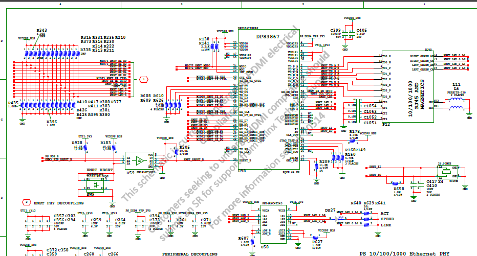

Setup:
  • Using DP83867 PHY in RGMII mode.
  • Observing differences between a working board and a non-working board.
  • Focus is on strap pins (e.g., RX_D0, RX_D2, RX_CTRL) and MDIO/MDC communication
Schematic:
Power-Up Observations:
  • Working Board:
    • RX_D0 is consistently low during power-up and reset.
    • RX_D2 is consistently low during power-up, matching expected behavior.
    • PHY communicates over MDIO/MDC, and MDIO/MDC toggling is observed.
  • Non-Working Board:
    • RX_D0 is high, even though it is pulled low in the schematic.
    • RX_D2 is also low, matching the working board.
    • MDIO/MDC do not toggle, and PHY is unresponsive to MPSOC commands.
Connection to PC PHY:
  • Despite these issues, the PHY on the non-working board successfully establishes a 100 Mbps link with a PC.
  • RX activity is observed via LEDs, indicating basic link functionality.
Request for Assistance:
  • Does the power sequencing of VDDIO relative to VDDA and VDD1P1 directly affect strap pin behavior?
  • Could slow ramping of VDDIO cause the PHY to incorrectly latch RX_D0 as high?
  • Are there other possible causes for RX_D0 being high despite a pull-down resistor in the schematic?

  • I will get back with ramp times of all rails after POR from MPSOC(XIlinx PL+PS device), its the PMIC which generates POR to DP83867 after the power rails stabilize, PMIC is TI TPS6508641
    I have also tried differently by using Reset button to reset post powerup, all these experiments are happening without programming FPGA,/ PS side of FPGA
    so there is no chance that MPSOC will try to send some signals of data
    can you please explain in what situation the strap pin D0 state would become like this, its not that phy is hanged or faulty its able to connect to PC for reception by FPGA to PHY link is not happening

    II dont much see any big difference or deviation, so i dont feel its the supply issue also
    i did a mistake and misunderstood that rxd0 is high post power on, but actually once the phy is connected to pc this status happens, so while testing the non working board i was plugging in the eth jack, the same i repeated with working board both behaved same
    coming back to the observaton, mainly the MDC and MDIO toggling doesnt happen between MPSOC and PHY which is were i am stuck, why this happens ? in what situiation, how to see through hardware pins if PHY is non functional ?
    I checked clk out and its perfect, now as per new observation, strap pins are also fine, ramp up of voltages is also fine, what else might be contributing to this unknown behavior ?

  • What i did is below
    1. Case 1 : populated a reset button and did hardware reset of PHY through the button to see if it comes out of some expected locked state, it did not happen
    2. Case 2 : tapped the MDIO and MDC pins during powerup, post powerup and post code flash in none of the cases the MDIO and MDC did not show any change/toggle
    Regarding RX_DO as i said it my mistake of testing, the RX_DO state is same in both boards during and post power up, so its not an issue.

  • Thanks for your time and efforts in helping me
    I blindly trusted the software tool chain, there was a issue with software configuration, because of this the code was not loading to DRAM and there by not runnning on PS side, so hence the eth core on PS side was not initiating any communication to PHY
    A clear situation of software bug
