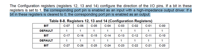

1.Are "Polarity Inversion Registers" registers that can invert the polarity of only the input ports?
2.Are the "Configuration Registers" registers that can only be configured for output ports?
       Also, could you please tell me in what specific cases these settings are necessary?
Best regards
  • ◆This will be an additional question.
    3.Do I need to set the configuration registers to 0 when using it as an output port? (Since the default is all 1s)
    4.Can't I just set the output port registers (registers 4, 5, and 6) to use it as an output port?
  • User6448843,
    Polarity inversion should affect both pins configured as inputs and outputs.
    Not exactly. Configuration registers are used to configure the direction of a pin. This register is used to configure whether a pin is a high-z input or a push-pull output.
    IO expanders are used when an MCU runs out of external GPIO's. Thus you can use the I2C bus as an extension of several IO's using our devices.
    Our IO expanders allow the user to configure many pins to their needs as a mix of inputs and outputs defined by the configuration register of the IO expander.
    This is correct. For example, setting bit C-07 = 0 will set P07 as an OUTPUT.
    C-07 = 1 will set P07 as an INPUT (this is default on power-up).
    You can think of the configuration register as the direction bit. It determines whether the pin is an output or an input (data flowing out, data flowing in).
    The output port register controls the logic on pins configured as an output. If the output port register is a 1 for a specific pin, then a logic HIGH will result. Likewise, if the output port register is a 0 for a specific pin, the corresponding output pin will pull LOW.

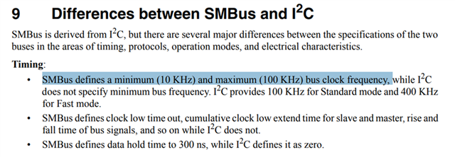

    I have the following questions about connecting via SMBus.
    1. Is the TCA6424A command format (communication protocol) the same as I2C?
    2. Is the function and operation of the /INT terminal the same as when communicating via I2C?
  • Additional questions regarding SMBus communication:
    3. Is the communication speed of SMBUS equivalent to that of I2C BUS?
  • This device is compatible with both I²C and SMBus hosts. (The SMBus specifications defines some optional features that the TCA6424A does not implement.)
  • User6448843,
    As Clemens mentioned to your points 1 and 3, TCA6424A is compatible with the SMbus protocol, minus some optional features.
    To answer point 2, the function and operation of the /INT terminal is the same with either I2C or SMBus protocol.
    Tyler
  • In a configuration where the host is connected via SMBus and the TCA6424A is connected to the slave, if the host outputs a clock (SCL) of 400 kHz, can the TCA6424A communicate at this speed?
    (This is a confirmation, as the SMBus communication speed is generally regulated at 100 kHz.)
  • User6448843,
    TCA6424A works up to 400 kHz I2C clock speed.
    Tyler
  • Sorry for confirming.
    1. Does the TCA6424A's SMBus support 400kHz?
     ※According to this reference document, the SMBus transfer speed is 10kHz to 100kHz.
    ◆Reference Documents
     www.nxp.com/.../AN4471.pdf

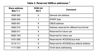

    2. Up to what SMBus specification version does the TCA6424A support?
     (For example, I would like to know whether the SMBus specification is up to v2.0 or v3.1.)
    Best regards.
  • User6448843,
    TCA6424A can support 400 kHz.
    I don't know the specific differences between the V2.0 or V3.1 spec.
    From a data frame perspective, TCA6424A can interpret SMBus messages following the start, byte, ack/nack, stop format. TCA6424A would not recognize the special reserved commands for the following addresses however. The more software defined features of SMBus are not supported by the TCA6424A.
