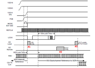

    At position #1 as shown below in the system power-up initialization sequence, we have to write all DES registers that need to be configured, see example code:
    WriteI2C(0x1F,0x00) # Set CSI transmitter speed to 1.6Gbps/lane
    WriteI2C(0x4C,0x01) # FPD3_PORT_SEL: RX port0 (0x01) or port1 (0x12)
    WriteI2C(0x58,0x5E) # Enable pass through
    WriteI2C(0x5C,0x18) # SER_ALIAS_ID
    WriteI2C(0x5D,0x60) # Image sensor ID
    WriteI2C(0x65,0x60) # Image sensor Alias
    WriteI2C(0x7D,0x01) # Enable PASS threshold
    At position #2 once you have a stable LOCK, configure the required SER and then Image sensor registers, for example:
    WriteI2C(0x02,0x13) # Set number of CSI lanes to 2, and I2C strap mode to 1.8V. If 3.3V is used, then write 0x12
    At this position you should monitor PASS indication on the DES --> reg 0x4D bit[1]. Once high, go to next step.
    At position #3 Enable DES CSI port and the enable port forwarding.
    WriteI2C(0x33,0x01) # Enable DES CSI TX port
    WriteI2C(0x20,0x20) # Enable port forwarding of RX port0. If both RX ports, the 0x00

  • Yes, this is recommended by the MIPI Aliance. Of course, your receiving SoC must support the calibration, otherwise you cannot use it.
