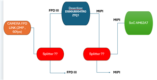

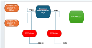

Our requirement is camera two csi-2 mipi data to be collected separately at another Fakra port (camera raw data) and simultaneously camera data to be processed across SoC AM62A7. So looking for splitter solution. I am updating the block level diagram.

For example, we have replicate port on some of our parts in the MIP side that can be used to send the data to another device. Where is the data going on the FPD side? Will it be on the same board as the DES? I need the full picture with what devices will be on the same board.
