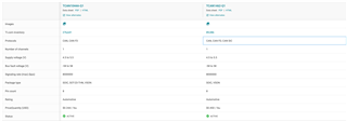

Hi Teams,
What are the differences between TCAN1044AVDRBRQ1 and TCAN1462VDRBRQ1?
Part Number: TCAN1044-Q1
Other Parts Discussed in Thread: TCAN1044A-Q1, TCAN1462-Q1
Hi Teams,
Hi Vayne,
The TCAN1044A-Q1 device do not include the signal improvement capability (SIC) feature while the TCAN1462-Q1 does (please help see section section 8.1.1 for more information on the feature), similar to below, thanks.
