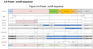

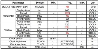

I only want to translate HDMI input to the FPD Link3 output. (the output resoluation is 1920*720)
Could you help me to provide the EDID file and the Script that I to write into the serializer. Below are the TFT parameters for EDID file.

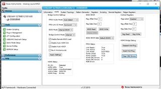

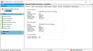

    Hope you have generated the EDID for the TFT timings that I have shared with you, because today I tried multiple EDID but I am not able to reflect the Video on TFT. I have generated pattern successfully but HDMI video I am not able to reflect. My PC is detecting and also I can be able to use 2 display in my PC but in TFT it is not reflecting. Few snaps from ALP tool after flashing of few EDID script.
    Fazil
  • Hi Fazil,
    It is the EDID decode based on the TFT timings. Please try the script.
    If it is not working with the EDID, please share register dumps of the UB949.

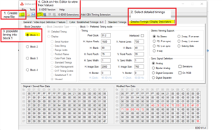

    Yes, definitely I will try and let you know. Can you please share me how do you generate the EDID and how can I edit.
    Fazil
  • Hi Fazil,
    I generated the EDID using 3rd third-party EDID generator and then replaced the exEDID with a changing format.
