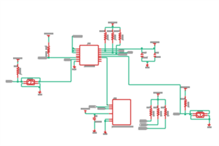

I am using the TMAG5273 Hall sensor and the 8-channel TCA9534A GPIO expander.
I connected the Hall sensor's interrupt pin to a GPIO pin on the GPIO expander, and I connected two switches to other GPIO pins. The GPIO expander's interrupt pin is connected to the microcontroller's interrupt pin.
During testing, I observed that the GPIO expander's interrupt pin is generating false interrupts or fluctuations.
Note: The Hall sensor is connected to I2C1, and the GPIO expander is connected to I2C2.
What could be the reason for these false interrupts or fluctuations?
  • Hi Puppala,
    The schematic does not allow me to zoom in to review the connections. Can you try a different file type?
    Are there any pins configured to INPUT and left floating on the TCA9543A? It could be that these floating pins are triggering a false interrupt.
    Any oscilloscope captures to show the problem you are running into?
