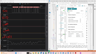

  • Hi Ethan,
    We confirmed that EN and nSTB are both high during operation, and now we are seeing both CAN lines being held high:

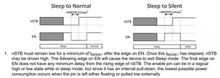

    If the device is in sleep mode somehow, does nSTB have to be held low for a period of time after the EN is pulled low, then afterwards pulled high again in order to enter normal mode?

  • Hi Aidan,
    That part of the datasheet you have highlighted depends on if the device entered Sleep mode because the SWE timer.
    If the device is in Standby mode for more than 5 minutes, the device will enter Sleep mode, which requires extra steps to exit out of that Sleep mode.
    For simple testing, EN and nSTB should be high when the device is turned on, and this SWE timer and respective EN/nSTB changing should not be a concern. If the device is in Sleep mode but not because of the SWE timer, then setting EN and nSTB high will set the device into Normal mode without issue.
    However if you can see CANH and CANL both pulled high (meaning the device is in Normal mode), then you should be able to begin transmitting on the TXD line.
