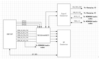

您好:
如下图我我司TMUXHS4446设计方案:
从高通SOC输出4对USB-C高速信号至TMUXHS4446,通过CONF[2:0]做输出选择;如果CONF[2:0]=010,则设计为DP输出模式;如果CONF[2:0]=100,则设计为USB传输模式(通过Type-C接口)
请帮忙确认设计方案有无问题,能否支持上述功能

Hi Young
For TMUXHS4446, USB signal and DP should be separate from SOC source, USB signal goes to SSTX/SSRX, DP signal goes into DPINx.
If USB and DP signal are from same channels from SOC, you need to use TUSB1044.
Best
