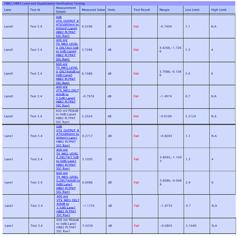

Our motherboard uses TI TS3DV642A0RUAR to switch DP signals from Raptor lake-U(SOC) and MXM module.

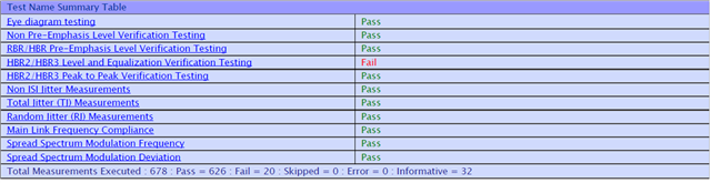

There are DP SI issues about HBR2/HBR3 Level and Equalization Verification Testing when we switch DP of Raptor lake-U.
Because lengths of DP is not over Maximum length of Intel PDG. Those SI issues are likely not caused by signal attenuation.
Do you have any experience related to SI failure of HBR2/HBR3 Level and Equalization Verification Testing?
Could you provide any suggestions on how we can resolve this SI fail issue?
Do you have any recommendations for the length and number of vias from the TS3DV642A0RUAR to the DP connector?
    Can you please share the full compliance report including the measured waveform?
    The TS3DV642 is a passive MUX and will not provide any tuning capability to these failed test items. You will have to tune the actual SWING and Pre-emphasis value associated with each level of Raptor lake-U(SOC) and MXM module in order to pass the test.

    The full compliance report is below.
    Please provide suggestions that can let us to improve DP layout.
    Thanks.
    DP1 CTS1.4 SSC test report.rar
    Looking at the report, the failure happens at HBR2 which will have higher insertion loss. So you have to tune the DP source SWING and Pre-emphasis setting associated with each level to pass the compliance test.
    For example, on this failure, the minimum spec is 5.104dB while the measured value is 5.0236dB. So you can bump up the 6dB setting a bit in order to pass the test.
