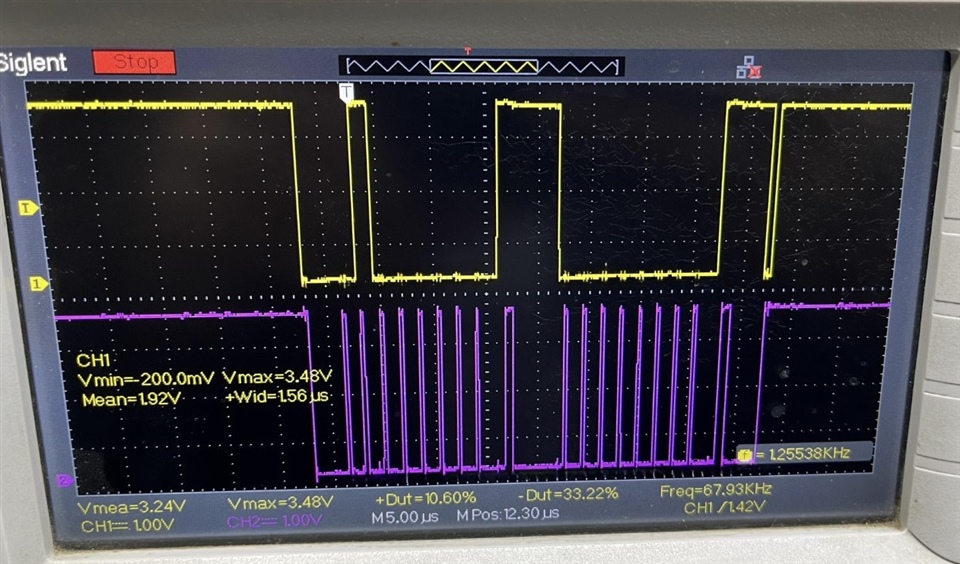

**Problem Statement:**
I am interfacing the PCF8574 with MSP430FR2422 using a bit-banging I2C implementation. Despite correct start/stop conditions and data transitions (verified on an oscilloscope), the PCF8574 always responds with a NACK after the address byte (`0x40` for write).
1. **PCF8574 Address:** A0, A1, A2 are grounded (address: `0x40`).

**Question:**
Why is the PCF8574 always responding with a NACK after the address byte, and how can this be resolved?
