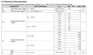

Hi TI team,
Im planning to use the TCA6408APWR as IO expander with vcc=1.8v, while doing DC analysis the VOH, VOL values are not available for the VCC=1.8V in the datasheet, due to which DC is failing if i take Values of VCC=1.65V. Please let me know the VOH,VOL values for VCC=1.8V
