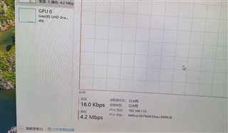

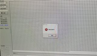

We use the DP83869HM for our 1000M Ethernet PHY, and now, the Ethernet transfer data will disconnect for stress testing in 10min sometimes,
Plesae refer to below image, the max. data package is only 4M, and the Auto Negotiation ( 1000 Advertised) is fine,

    I would imagine that there are significant signal integrity issues or PHY setup issues that are contributing to this reported behavior.
    As next step, I would advise consulting against our DP83869 troubleshooting guide to rule out the common issues. If the document is not able to resolve your issue, we can take up further on this thread.
