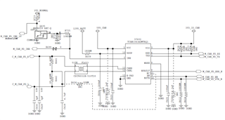

Customer found TCAN1463-Q1 can' t detect fault on CANL short to GND case as below, TCAN1043A-Q1 detect well but no fault on it with TCAN1463-Q1.
You can check scope screen, same test condition and Fault pin wave as well on both.
Please let me know what customer can check for it or more data to check in your side?
BR.
    What is data rate of this testing above?
    Their schematic looks good, if there any difference on PCB layout for TCAN1043A-Q1 & TCAN1463-Q1?
    Sean

    Sorry I don't have a good explanation of why TCAN1043A-Q1 works but TCAN1463-Q1 not. Because CAN SIC have a different bus pin architecture, the current measurement are also different. We do not have any other device as a pin to pin alternation as their nFAULT works all the same, TCAN1145-Q1 has a more advanced bus fault detection feature but it's a device using SPI, there is no nFAULT pin on that device.
    I'm trying to understand how their CAN bus circuits can affect the nFAULT toggle, do they have the same CAN bus layout of TCAN1043A-Q1 and TCAN1463-Q1 on the board? Right now the only difference we can notice on schematic is that bus filter capacitors. If they depopulate C601 and C603, will the test result change?
    Sean

    There're 2xTCAN1463-Q1 and 3xTCAN1043A-Q1 on same board and almost same layout(additionally 4xTCAN1044AV-Q1).
    And they might not test without Cbus 7pF CAP, can we recommend to reduce it as TCAN1043A-Q1 circuit has as 3pF ?
