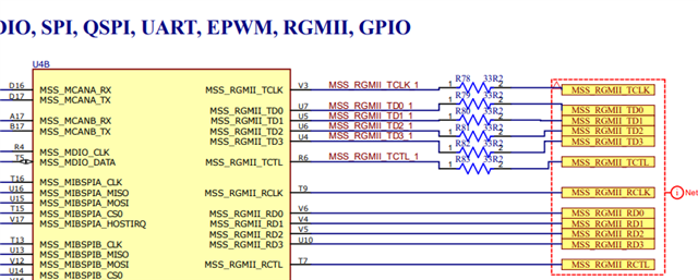

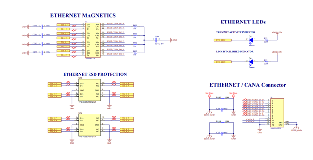

We have designed some custom RF and Digital boards based on the AWR2944EVM evaluation board. We have the AWR2944 radar transceiver on the RF board and the DP83867E Ethernet PHY on the Digital board, with a Samtec QTS-0 5 0-0 2-X-D-A board-to-board connector used to transition RGMII signals between the boards.
We are having issues communicating with the board over Ethernet - when we run the TDM Ethernet example provided in the SDK and enter queryLocalIP we get an IP address returned of 0.0.0.0. When running our own custom firmware we get 'link is not up' message. We have connected from the board via a router (same setup proven with AWR2944EVM board).
It seems that auto-negotiation is not happening as the clock from the MAC on the AWR2944 to the Ethernet PHY (RGMII TX CLK) is at 25 MHz speed (for 100 Mbps rate) but the clock from the Ethernet PHY to the MAC on the AWR2944 (RGMII RX CLK) is at 2.5 MHz speed.
We have tried in the firmware things like adjusting delay between clock/data (tx/rx delayInPs variable), forcing 10 Mbps speed (with auto-negotiation off) but no luck in getting it to work.
See screenshots below from board schematics:
Digital board:
RF board:

    Differing registers:
    PHY 0: PHYSTS      = 0x7c02 : 0x0302
    PHY 0: ISR         = 0x1c42 : 0x0040
    PHY 0: STRAPSTS2   = 0x0100 : 0x0130
    PHY 0: RGMIIDCTL   = 0x0077 : 0x0017
    PHY 0: IOMUXCFG    = 0x0c0f : 0x0c0e
    PHYSTS:
    0b0111'1100'0000'0010 - eval board
    0b0000'0011'0000'0010 - custom PCB
    15:14 - Speed selection. 01 = 100Mbps, 00 = 10Mbps
    13    - Duplex mode. 1 = Full duplex, 0 = Half duplex
    12    - Page received. 1 = Page received, 0 = Not
    11    - Speed dupler resolution. 1 = Auto-Negotiation has completed or is disabled. 0 = Auto-Negotiation is enabled and has not completed.
    10    - Link Status, 1 = Link is up. 0 = Link is down
    09    - MDI/MDIX Resolution Status for C and D Line Driver Pairs. 1 = Resolved as MDIX, 0 = Resolved as MDI
    08    - MDI/MDIX Resolution Status for A and B Line Driver Pairs. 1 = Resolved as MDIX, 0 = Resolved as MDI
    ISR (1 = Interrupt is pending, 0 = No pending interrupt):
    0b0001'1100'0100'0010 - eval board
    0b0000'0000'0000'0100 - custom PCB
    12    - Page Received Interrupt.
    11    - Auto-Negotiation Complete Interrupt.
    10    - Link Status Change Interrupt.
    06    - MDI Crossover Change Interrupt.
    03    - Wake-on-LAN Interrupt.
    02    - xGMII Error Interrupt.
    STRAPSTS2:
    0b0000'0001'0000'0000 - eval board
    0b0000'0001'0011'0000 - custom PCB
    06 : 04 - RGMII Transmit Clock Skew Strap. See RGMII Transmit Clock Skew Details table for more information.
    RGMIIDCTL:
    0b0000'0000'0111'0111 - eval board
    0b0000'0000'0001'0111 - custom PCB
    07 : 04 - RGMII Transmit Clock Delay. 0111 = 2ns, 0001 = 0.5ns
    IOMUXCFG:
    0b0000'1100'0000'1111 - eval board
    0b0000'1100'0000'1110 - custom PCB
    04 : 00 - Impedance control for MAC IOs. Output impedance approximate range from 35-70Ω in 32 steps. Lowest being 11111 and highest being 00000.
    Notes and questions:
    1. Why would PHYSTS indicate that 'Auto-Negotiation has completed' after a transition from RESET_WAIT to ENABLE state?
    2. ISR statuses double down on the information obtained in the PHYSTS.
    3. Why do we have a strap for Transmit clock skew?
