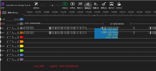

Customer found some issues about IIC, SCL will disappears intermittently when in 20Mbps coxial mode, pls check the excel file for details.
The registers are uploaded too, pls review and analyze the reason. Thanks.

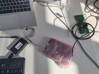

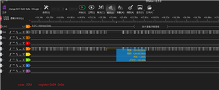

  • We tested three boards, and all had this problem. And just read it a few more times, and it will happen. The phenomenon of the problem is the same, for problem 1, the SCL is always lowered by 238ms when the host message is received for 20M, and for problem 2, the host reads back 257 bytes, the SCL is always lowered continuously and does not recover. We did the BC watchdog test, the value of 0x04 register is set to 0x0e, the phenomenon is shown in Figure 2, it does not seem to be a problem of BC watchdog.
    In addition, we verified several sets of FPD-link devices, and they all performed the same, so we can rule out a hardware problem in one device. serializer is on TI EVM, deserializer is on our screen.

       These problems occur all the time, and for problem 2, the decrease in the length of bytes read back by the host decreases the frequency of errors.

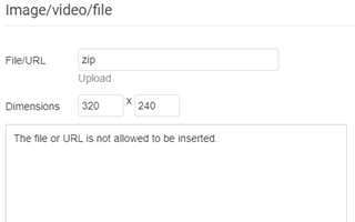

    the zip file can not upload in this web, which only 3.8M, and log file either, can you give me another communication way?

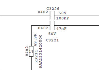

    Could you please check the hardware on the board:
    - what AC- coupling capacitor values are used on 949 and 948?
    - does the -ve FPD-Link trace have termination, as required for coax mode?
    - what is the MODE_SEL set to? If possible please change the switches on the the TI EVM, and resistor values on 948 display to the correct mode strap.
    - are there other components in the FPD-Link line? Is there any adapters used on the cable?

    I have a question, if DES RX_MODE_STATUS 0x23 = 0x18,and DES MODE_SEL register 0x37 = 0xAA, dose it work for coax 20M mode.
    1.for question "- what AC- coupling capacitor values are used on 949 and 948?
    - does the -ve FPD-Link trace have termination, as required for coax mode?"
    we rework TI EVM as follow figure
    2.for question "- what is the MODE_SEL set to? If possible please change the switches on the the TI EVM, and resistor values on 948 display to the correct mode strap."
    we change the resistor for correct
    3.for question "- are there other components in the FPD-Link line? Is there any adapters used on the cable?"
    we don't have other components. And there is no other adapters. we communiction line as blew
