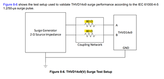

We seek your inputs & clarification on following queries in regards to the IEC 61000-4-5 Surge testing of the THVD1439
  1. Why is there a 80Ohm coupling network - what does this imply?

  • 1. The 80 Ω resistors are from the IEC specification. I can neither confirm nor deny whether this is an accurate simulation of your actual circuit.

  • Why is there a 80Ohm coupling network - what does this imply?
    Clemen's already answered this but this is just called out by the standard.

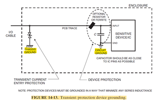

    The reason for our confusion is also highlighted in following from Henry Ott's text - we are currently using THVD1400 & have added the TVS as shown in the following figure & have had a properly functional system.
    The THVD1439's internal TVSes dump the current into the VCC/GND decoupling capacitor that you should already have; if the connector is some distance away and you have other protection components there, then it might make sense to add a capacitor there (on whatever power rails you're using there).
    With new THVD1439 - I am unsure how to separate the Digital ground & the Chassis grounds - physically we can - but electrical implications are not very clear as digital ground (ie the circuit ground in following figure) shall be carrying active signal currents which we do not want to be part of the chassis ground - kindly suggest if the MLCCs on the Vcc to Gnd of the THVD1439 might be sufficient to help minimize the upset due to dumping of the transient on digital/circuit ground?
    We have MCU & EEPROM on the same PCB & the size of the PCB is small 45mmx35mm.
    Can we add additional decoupling MLCCs like 3x 0603 100V rated MLCCs on the Vcc to GND of the THVD1439 to improve the transient dampening that is shunted by the internal TVS? Or do we add a 100pF 2kV rated MLCC to Chassis Ground on the input side for each A & B? Kindly guide in this case.
  • Hi Neet,
    I'm not actually sure the device has MLCCs internal to the device or not. The surge protection from these devices I believe come from additional TVS diodes (I believe we place an additional TVS diode die to sit on top of the existing THVD die, so the external die which is larger can handle the power from the surge event).
    You can probably do it this way. The capacitor values if they are 100pF shouldn't affect the RS485 communication during operation too much. They probably do want them to be close to the same value ( lower tolerance) to ensure the A/B lines don't skew too differently (we want A and B to have the same loading conditions).
