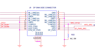

  • Hi David
    Does CONFIG1 is specific pin ?
    I don't see tne pin out is related to CONFIG1.
    or HDMI and DP signal is set by SCL/CFG0 ?
    Please see attached DP141 EVM schematic,
    1803.INT029A_schematic.pdf
    CONFIG1 is a pin of the DP connector, pin 13.
    David

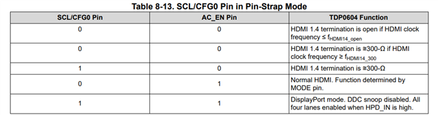

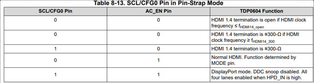

  • Hi
    How to set for HDMI or DP signal redriver on  TDP0604 ?
    is there any specific config pin on TDP604  ?
    This is set by the SCL/CFG0 and AC_EN pin as shown below
    If SCL/CFG0 = 0 and AC_EN = 1, with DC-coupled input, then TDP0604 acts as a HDMI re-driver.
    If SCL/CFG0 = 0 and AC_EN = 1, with AC-coupled input, then TDP0604 acts a DP++ to HDMI level shifter
    If SCL/CFG0 = 1 and AC_EN = 1, with AC-coupled input, then TDP0604 acts a DP re-driver.
    If
       CPU get CONFIG1 low , then CPU send out DP electrical with DP protocol.
       CPU get CONFIG1 high, then CPU send out DP electrical with HDMI protocol, and you will need a level shifter to convert from DP electrical to HDMI electrical while keeping the HDMI protocol.
    David
