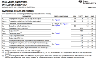

The datasheet lists the following limits
Practically, we had expected some jitter around the order of 150ps - not the 1000 ps we are seeing now.

    This is a long shot, but I wanted to check something that could possibly explain this:
    The datasheet mentions some output skew. It's not like the receiver actually tries to -align- incoming transitions, or does it? (in order to "clean up" the signal, and provide better signal-to-signal skew).
    If it were, it would explain what I am seeing. Such "aligning" would, by definition, slightly delay one signal based on what the other does, which in my case would explain what I am seeing (sometimes delays upon coincidental transitions, otherwise no delay).
    But .. again, I would be somewhat surprised if the chip was actually designed this way. But perhaps you could clarify that?
    Thanks for your feedback!
  • Hi Arnout,
    Thanks for clarifying and providing this information. The device does not try to align the outputs - rather, the output skew metric is related to the unintentional mis-alignment of multichannel outputs.
