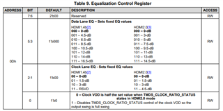

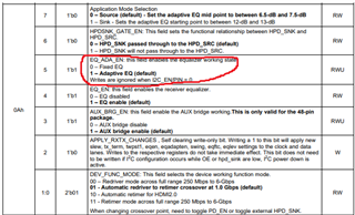

    In I2C mode you can set EQ using register 0x0A to set fixed EQ, then register 0x0D for the EQ value.

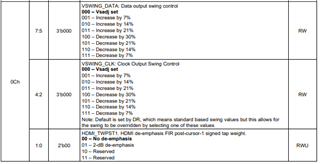

    You can set DE using register 0x0C (last two bits):

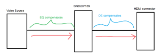

    2. You should set the EQ based on the channel loss from the video source. If you have a long cable or trace length between the source and the DP159, you would use a higher EQ value to compensate for the channel loss. A short trace length would use a lower EQ setting.
    DE is based on the channel loss from the DP159 to the HDMI connector. If you have a short PCB trace from the SN65DP159 to the connector, you may not need DE at all. If the channel is longer, I recommend using the -2dB setting.
