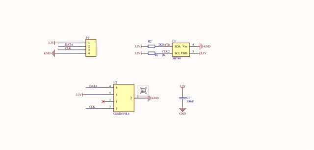

Due to the previous generation IC‘ EOL, the new one with ESD immunity downgrade from HBM 4Kv, MM 200v , CDM 750V/500V to ESD HBM 2Kv, CDM 500V.
After using the new one, we encountered device failure after assembly process.
in order to solve this issue, we chose ESD protection IC, the situation has improved, but not completely solved.
the SCH as following
the PN of ESD is CESD5V0L4
CESD5V0L4.PDF
let me explain our assembly process in detail
Wrapped in epoxy resin glue PCBA--1, through the ABS material tube-2, in the process there will be a chip on PCB damage, would you please help to recommend a TI suitable ESD chip can be as far as possible to solve this issue?

    Based on the operating voltage of the IC (SHT40), a protection diode with a 3.6V working voltage will be needed. If you are open to switching the package, I would recommend our ESDS302 device. It is a 2-channel device in SOT-23 and has 30kV ESD protection.
    I believe the reason why failures are still occurring is because the current ESD diode has a higher working voltage which in turn means the clamping voltage is higher and is not protecting the downstream IC.

    changing the package is acceptable, but i need to make sure the dimensions are OK, as shown in the picture the size of the PCBA is limited by the inner diameter of the tube. if there is the same function when the size is smaller it is also very welcome. i will evaluate the possibility of SOT23 today.
    there is  a question to be confirmed. During assembly, the connection wires corresponding to the 4 pins of VCC/GND/SDA/SCL are float status, not connected, will this affect the ESD302 protection effect?

    So the protection device won't protect the IC unless it is connected. The ICs ESD HBM and ESD CDM should be high enough to survive manufacturing and assembly, so if it isn't, then I would recommend reaching out to the company that makes the device.
